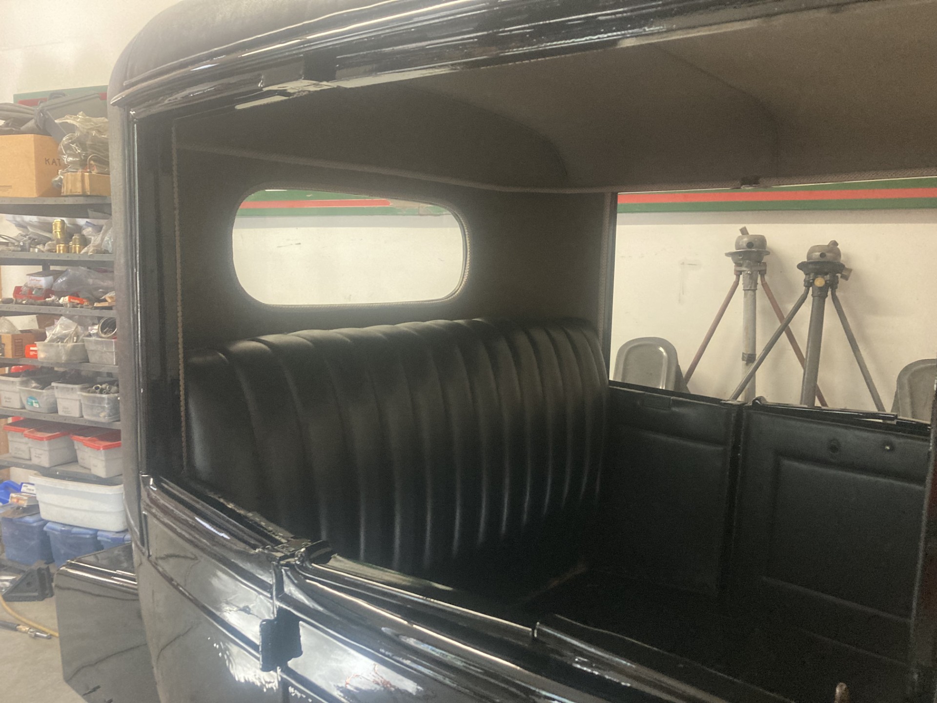

thumbnail_IMG_1485
The original chassis has been disassembled, and the engine has been rebuilt and is ready to install. The interior is in great condition and will not need to be replaced.

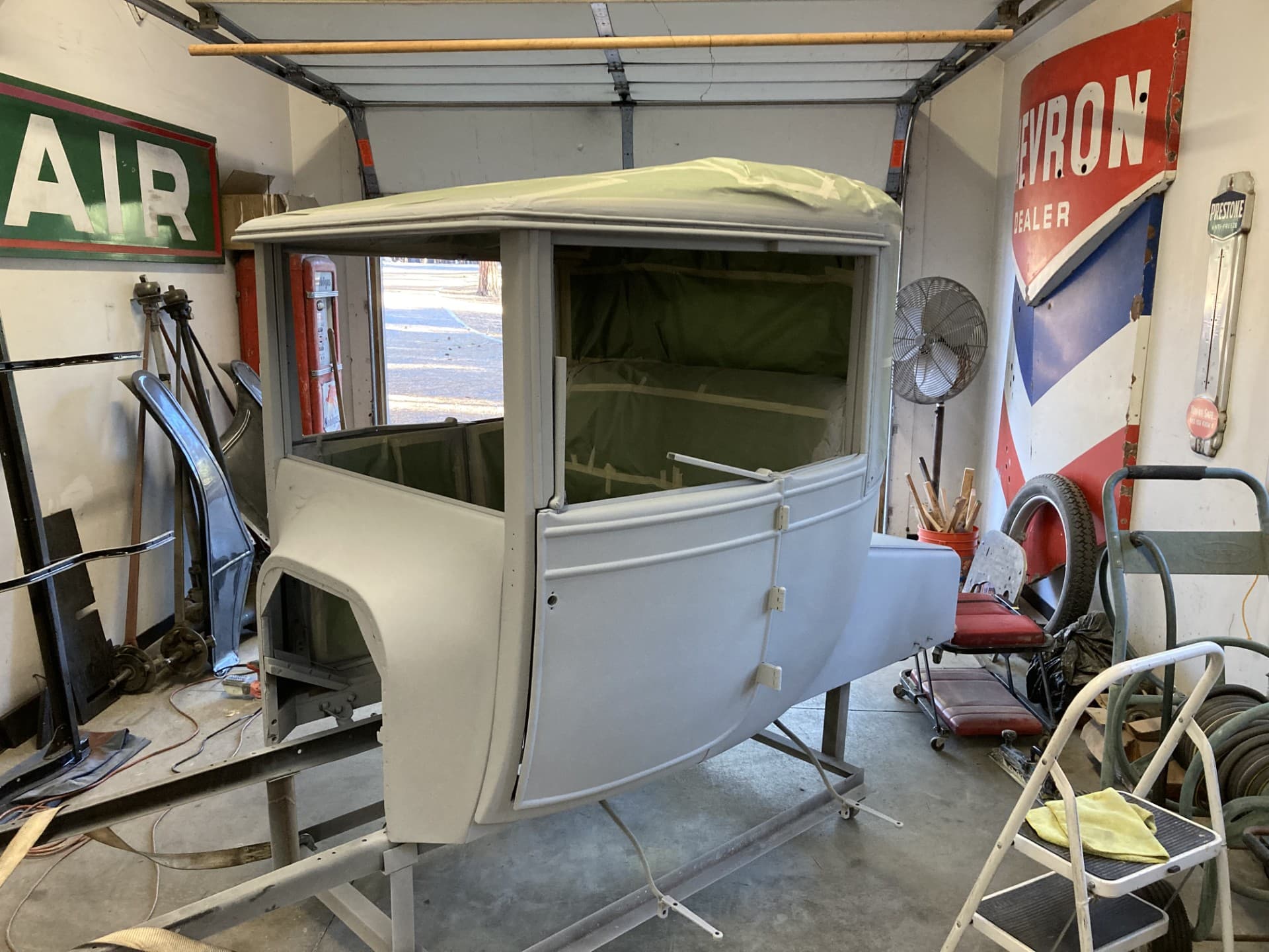

The 1917 Coupelet is s coming along slowly. The body was removed from the late chassis last week and placed on it nose so I can clean and restore the underside of the body. The wood in the body is in extremely good condition and before removing the body from the chassis, I aligned the doors, which now close perfectly. I stripped five layers of paint off the sheet metal that is in near perfect condition. I’m sure this car was kept in an enclosed garage its entire life.
I plan on sanding the sheet metal and then prime the body. I will paint the car with single stage Limco urethane paint in the spring when it warms up.

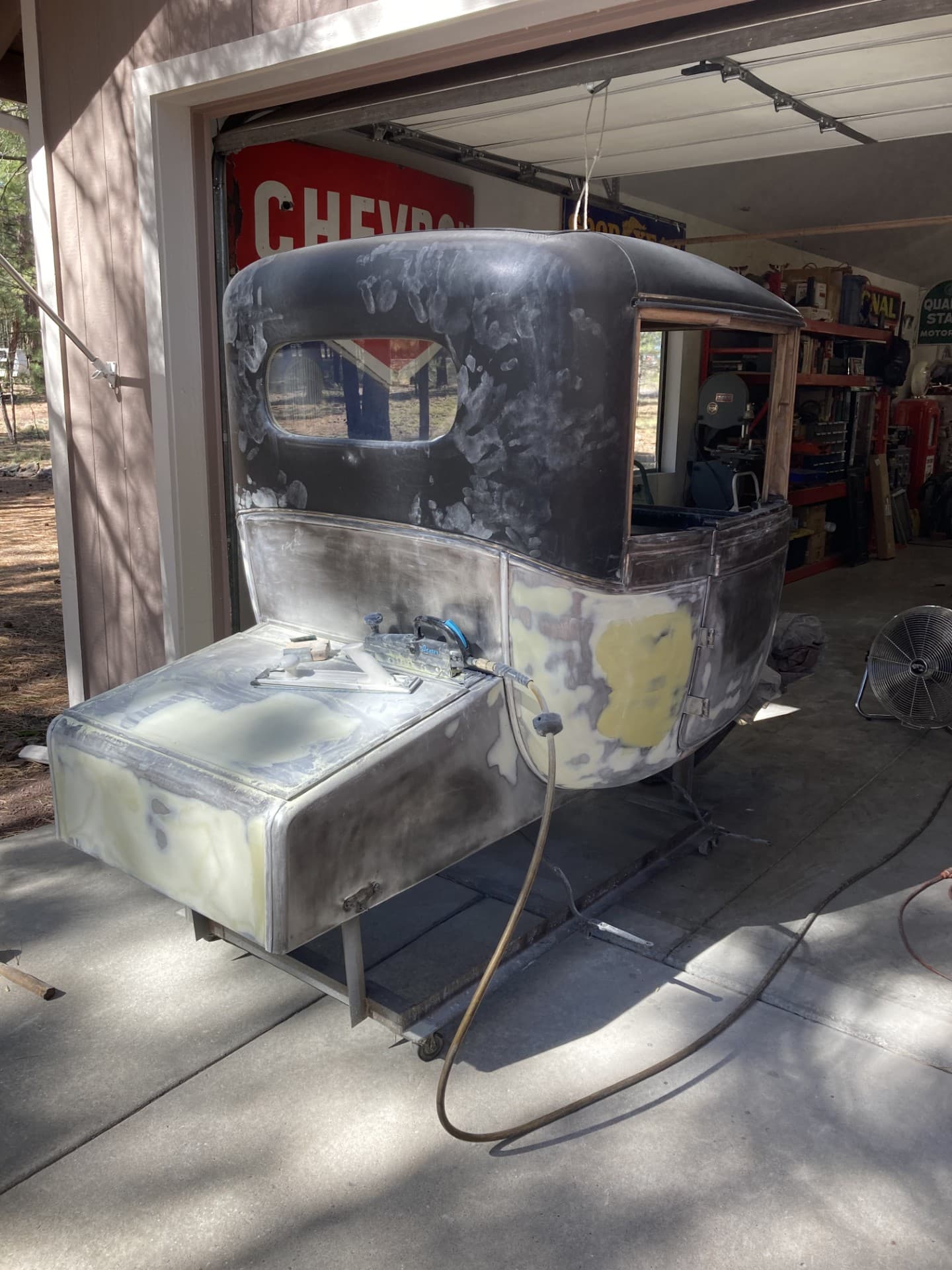

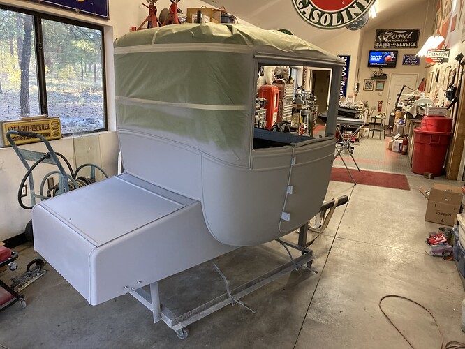

It has been a while since the body was removed from the chassis, but the body work is nearly done. Since the car has all of its original wood, I did not want to do any welding/brazing where the sheet metal had holes drilled. To repair the holes, I took small patches of sheet metal and used panel bond to hold the patches in place. This worked extremely well, and there was no distortion of the sheet metal. The body panels have no rust and are in excellent condition, but there were a few areas that needed a skim coat of body filler to be perfect. After blocking the filler, high fill primer was applied and is currently being block sanded. Once the primer is blocked, the car will be painted black. The underside of the car was sanded and painted gloss black earlier. I checked the underside for color, and the car was definately black.

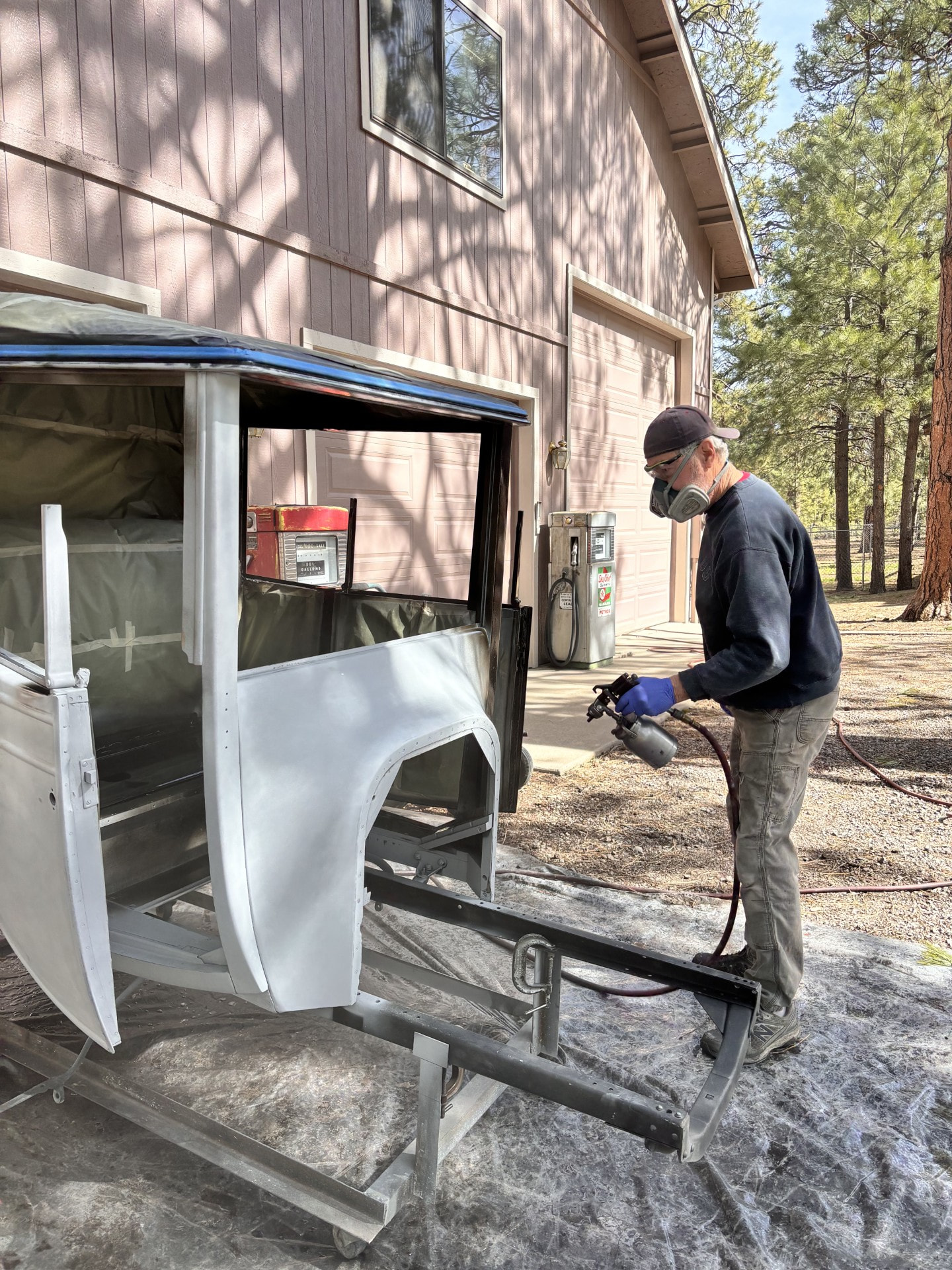

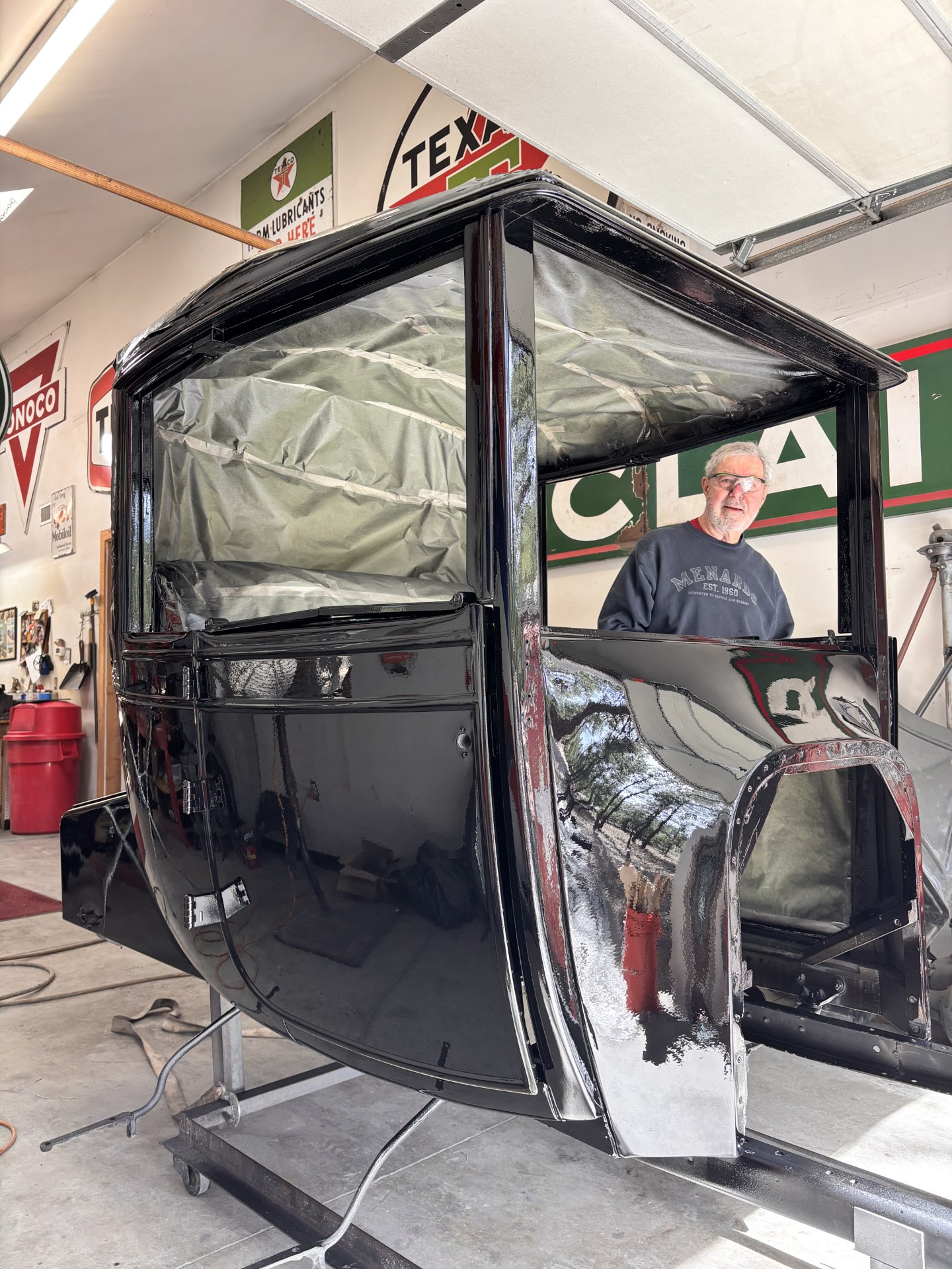

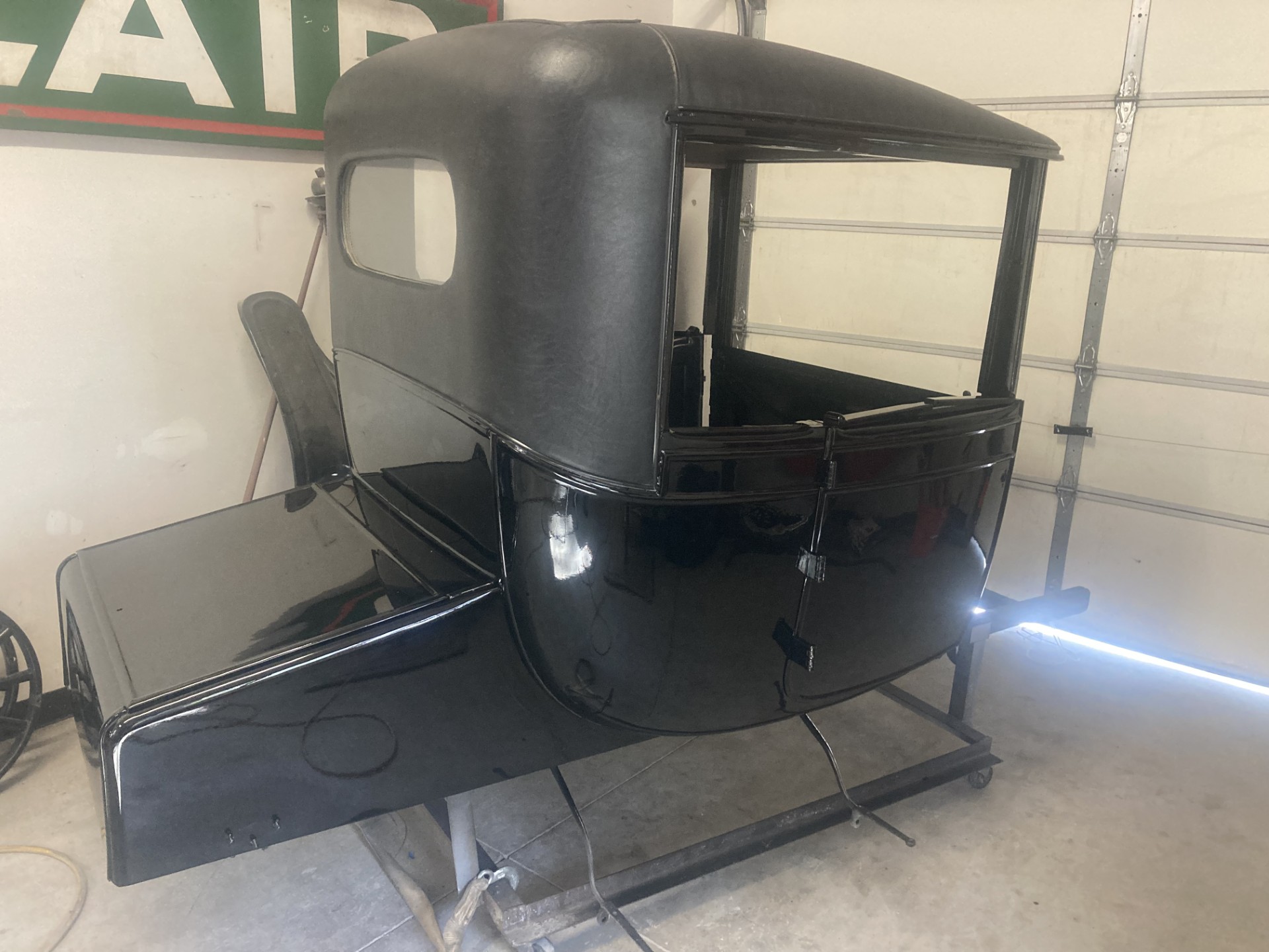

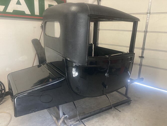

More progress has taken place. The weather in Flagstaff was great this weekend, so it was decided to apply the final coat of black paint on the body. The body was painted outside as I don’t have a spray booth. I used Limco Supreme Urethane single stage “Black Onyx” for the paint. Overall, I’m very satisfied with the final product. I will cut and buff the paint in a few weeks, and will begin to install the interior trim to complete the body. I have to restore the rear axle and paint the wheels, and then the body can be mounted to the chassis.
Looks great, Russ! :slight_smile:
