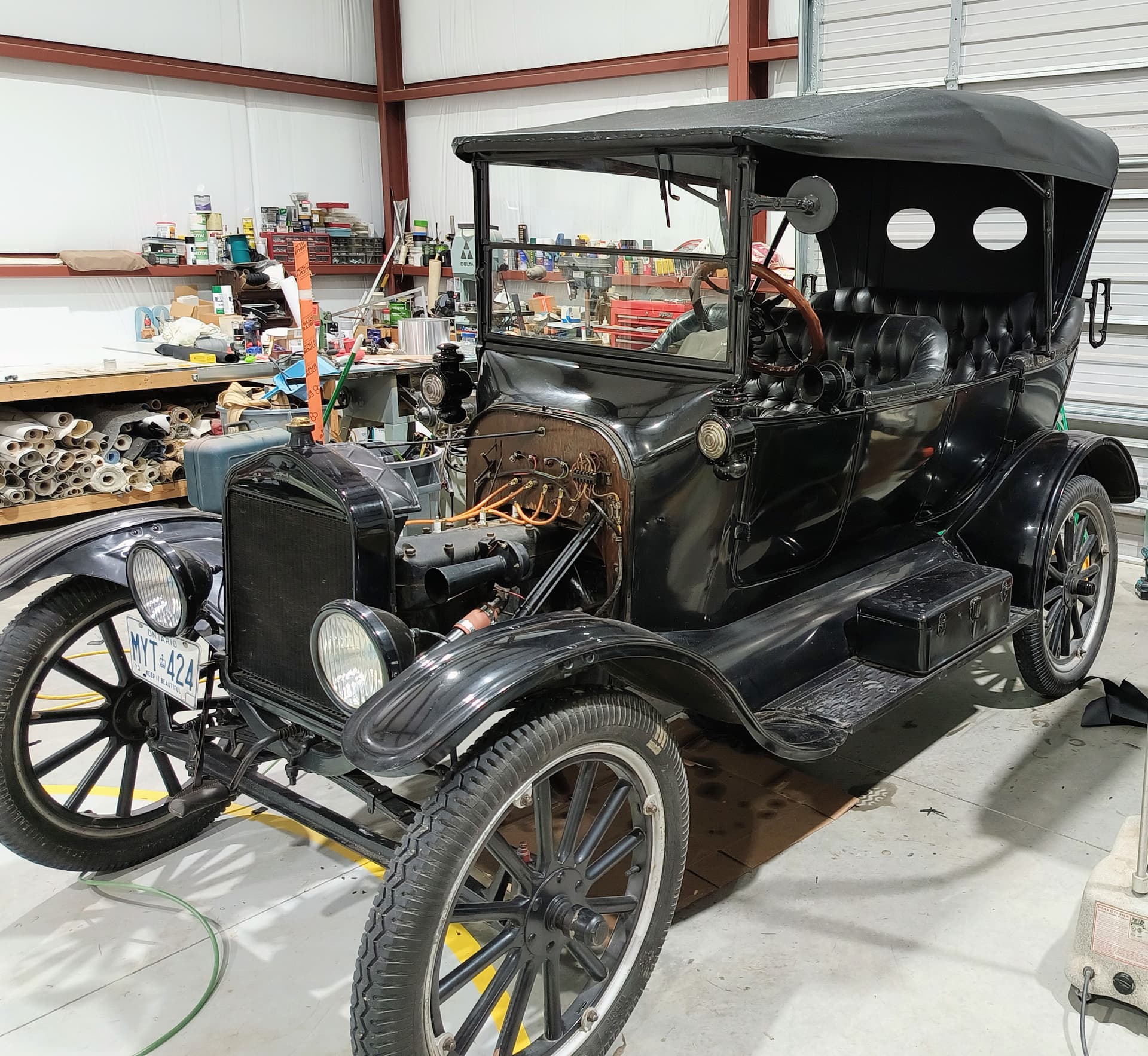

My 1920 T has a 1 man top and a straight up windshield frame. I’ve read that Canadian built touring cars sometimes had newer styles than usa built. Every picture I can find of cars with the one man top,have a slanted windshield. Is it possible that my car has the wrong windshield frame? As I go through the car, I’m finding many things that are not correct so wouldn’t be surprised if it’s supposed to have the slanted frame. Can anyone help me on this?

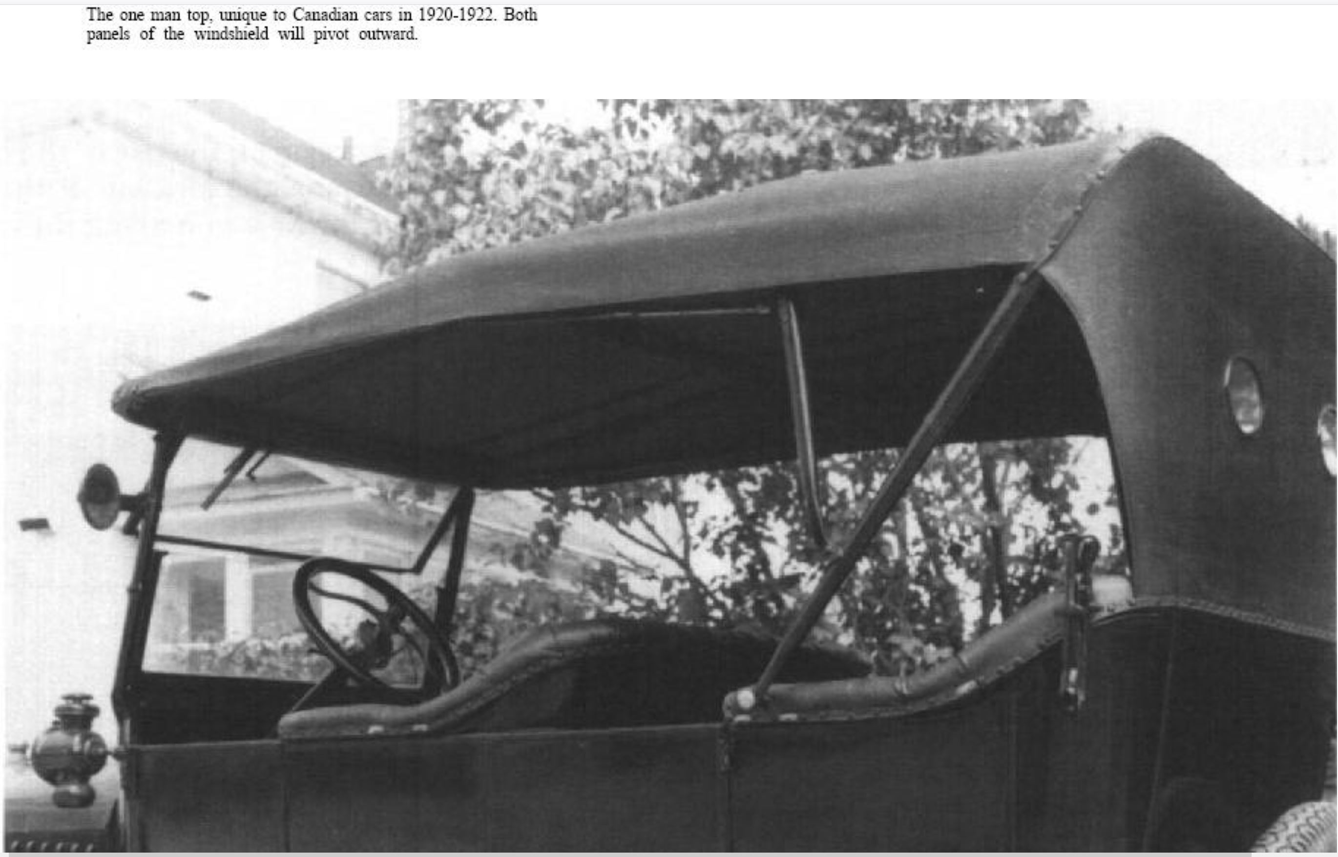

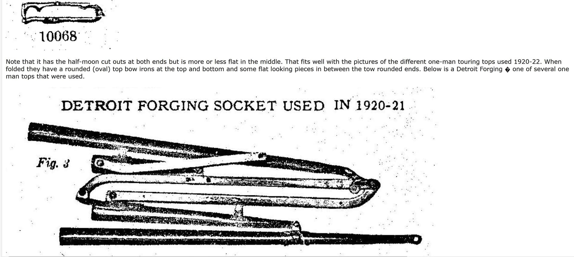

There was a discussion about the Canadian 1920-22 Touring one-man top and windshield on the other forum. Date was August 2007 by Hap you may want to take a look at. The windshield seems to be special also and could be why you have what you have. It also has different top-iron support clamps than U.S.
. Attached is a clip out of that thread.
Same discussion gave this as the correct clamps and irons.
Thanks for the info and pictures. I can see in the photo that the windshield is slanted. The clamps match what is on my car. Top frame irons look the same too. I’m planning to replace the top soon, I’ve done several of them before. I’ll make my own from scratch and put the correct shape rear windows in. I’m thinking I’ll get windshield stanchions for a 23-25 usa built car. Should take care of my issue. The top frame doesn’t sit right on the straight windshield frame.

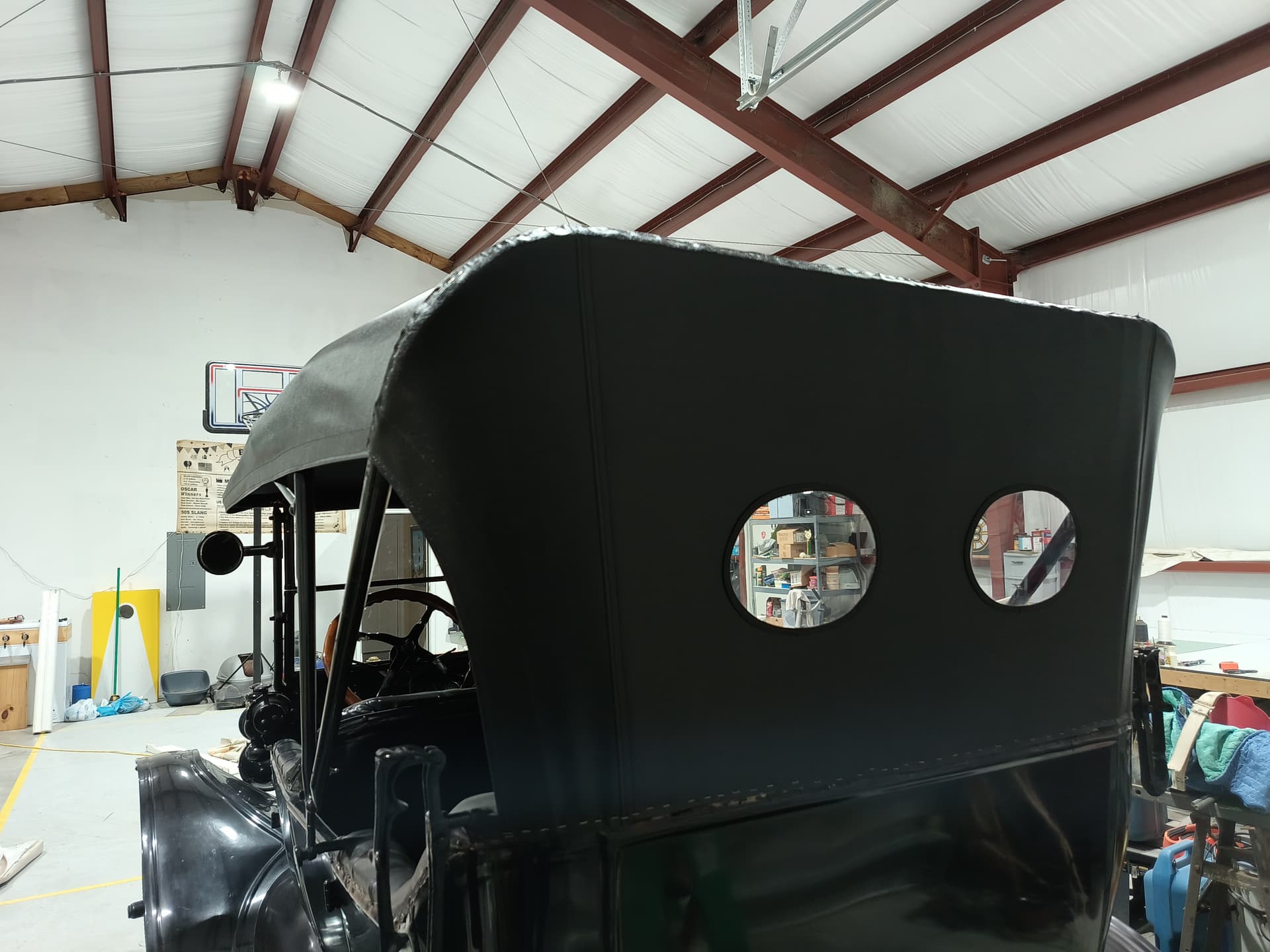

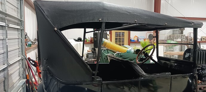

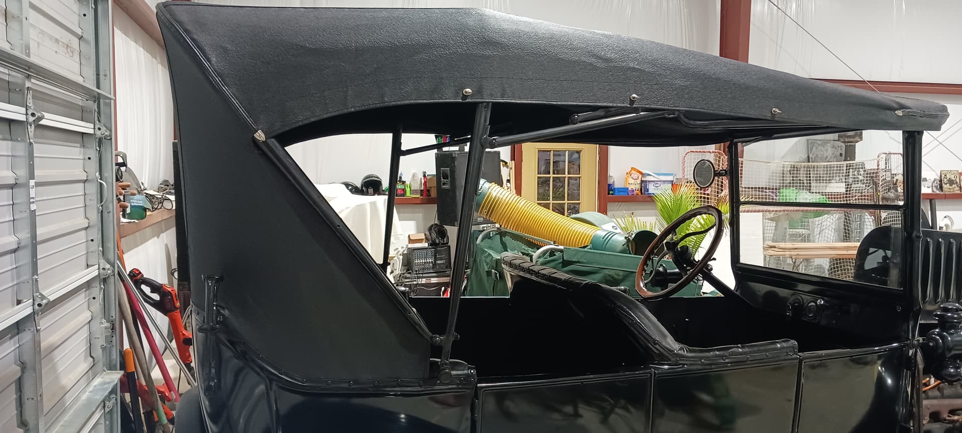

I believe I got the top frame sorted out. Fit much better without the top material on it . Made a new top using photos of Canadian built cars as reference. I’m happy with it , came out pretty good. Fits the windshield better and folds down into the clamps like it should.

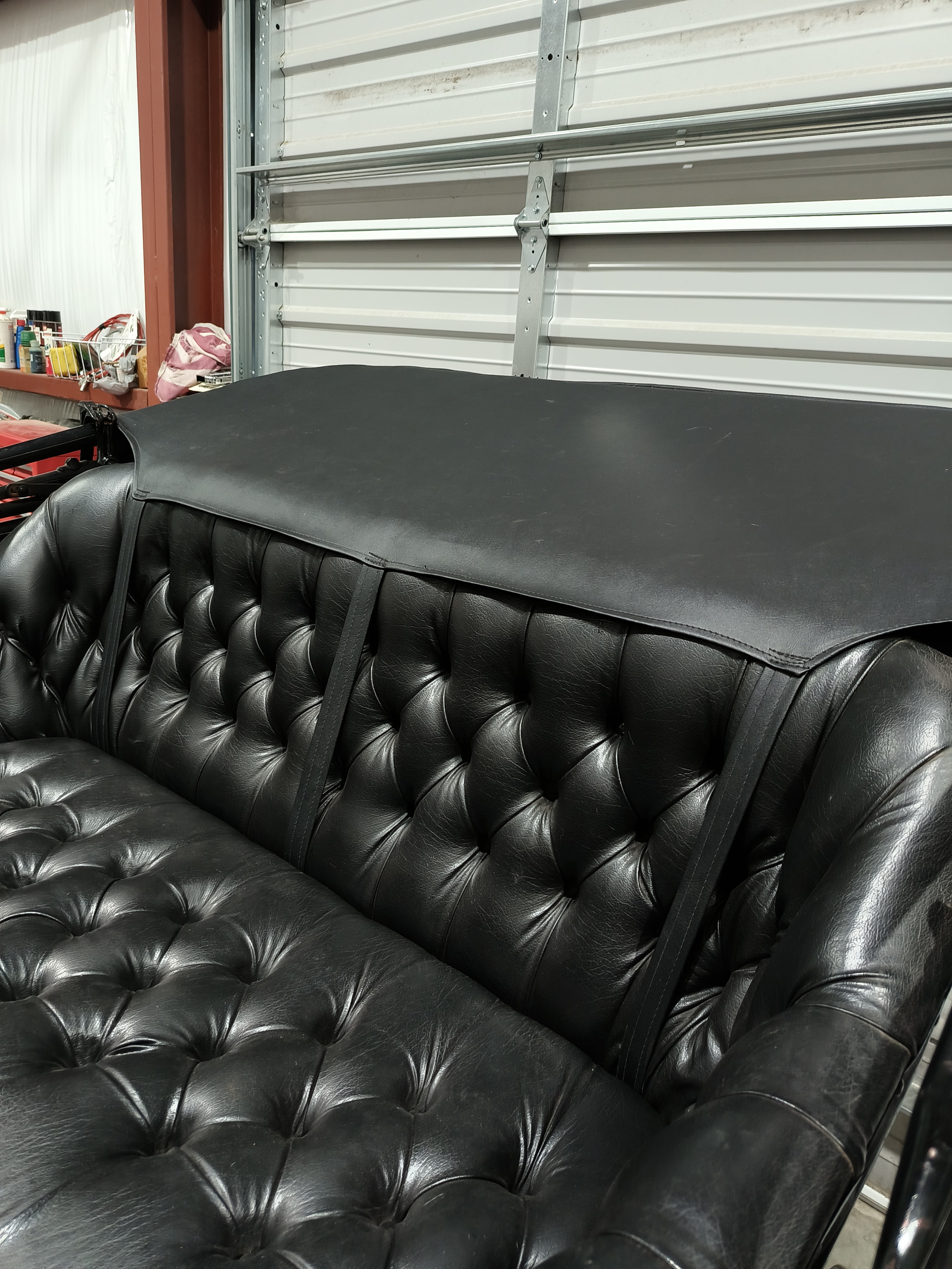

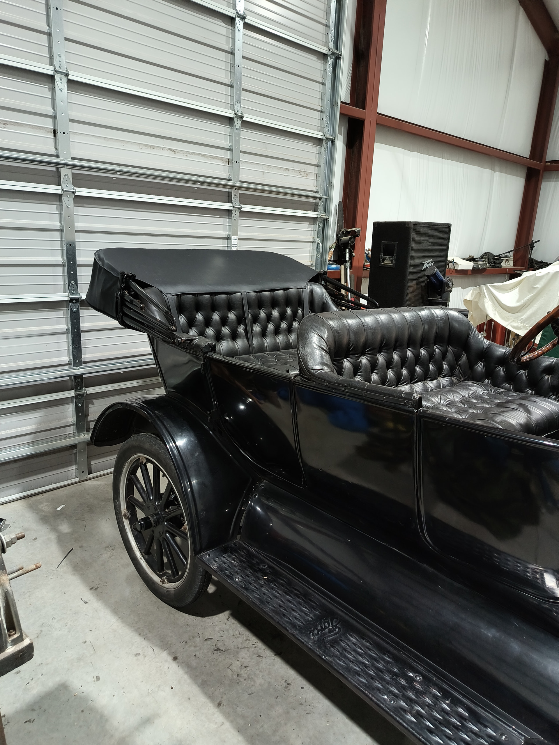

New top folds down nicely and fit in the clamps as it should. Made a top boot and ready to go!
