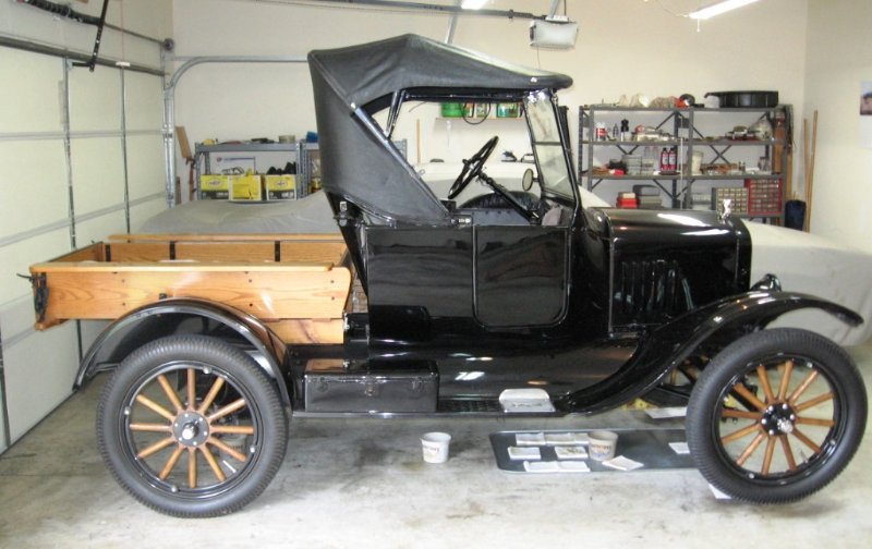

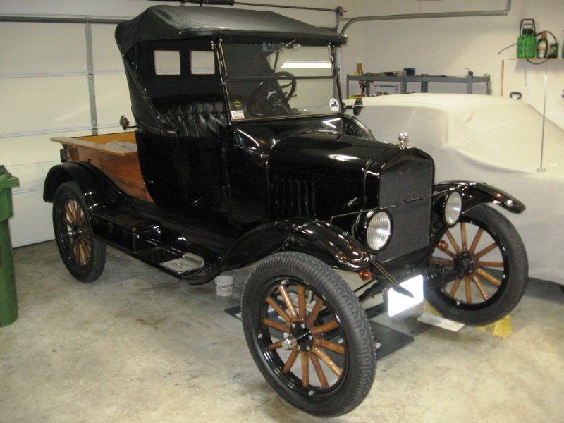

Here are some pictures of Betsy, my January 1924 cut-off touring car that was converted to a pickup back in the 1950’s. The previous owner had it restored in 2008 and I bought it from him in 2013.
If you are very tall or long legged as I am then you might find that 1926 - 27 Model T’s are too small. I have trouble driving them comfortably. For sure if you think you are interested in that body style, sit in one and see how you fit before spending a lot of time on one.

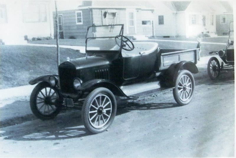

Personally I like the 1925 roadster pickup better. Here’s pictures of one my dad owned when I was little.
I’m with Royce on this one. 1926-7 models were not made for tall people. I have a '25 like the one Royce pictured, and it’s way more comfortable to drive. I’m 6"3". If you are going to make any changes, now is the time to do it.
