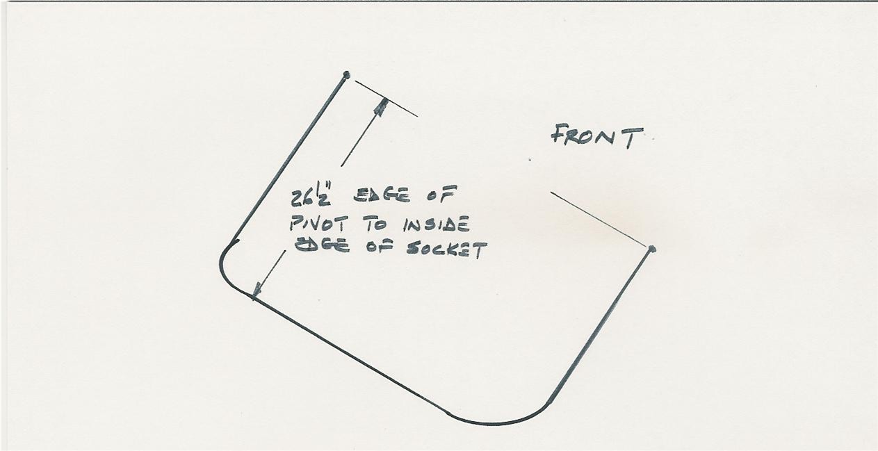

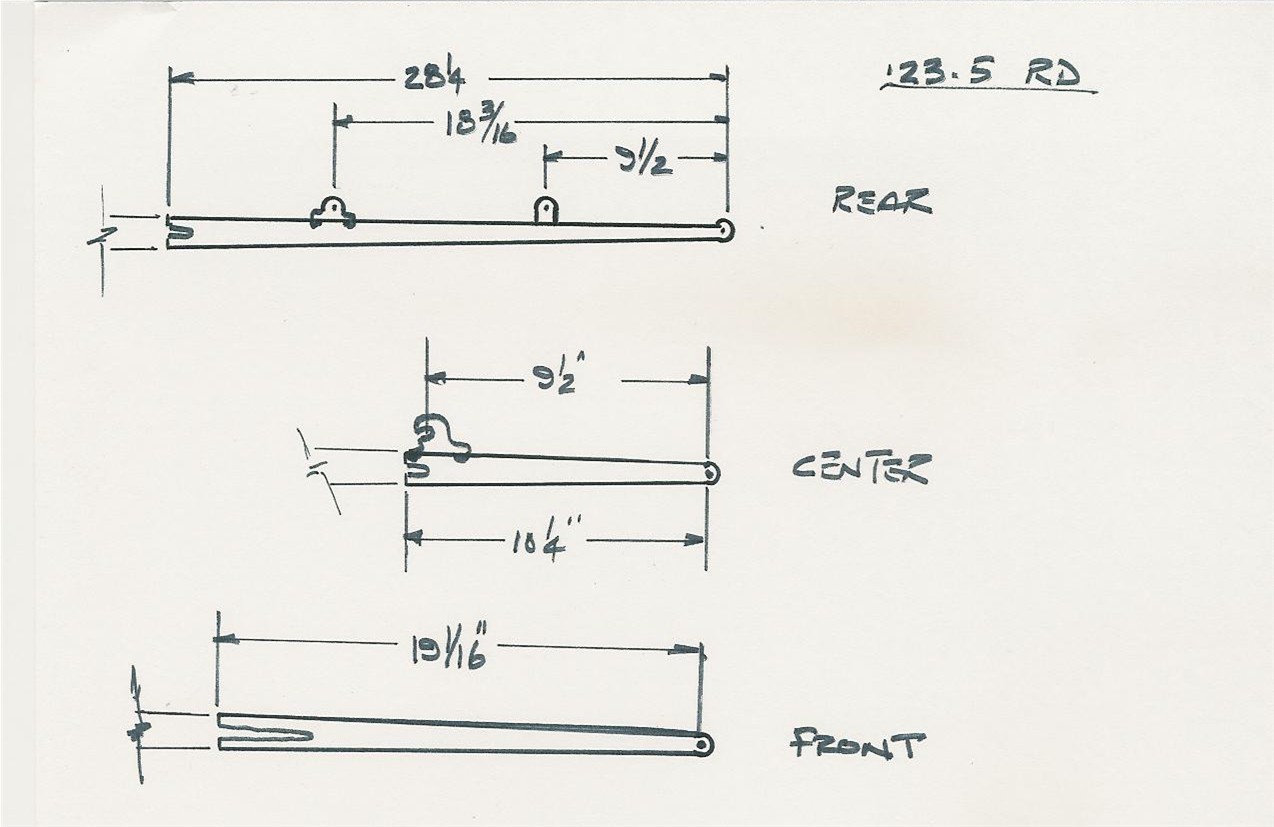

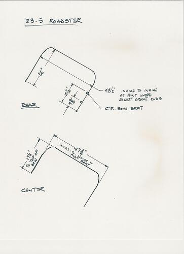

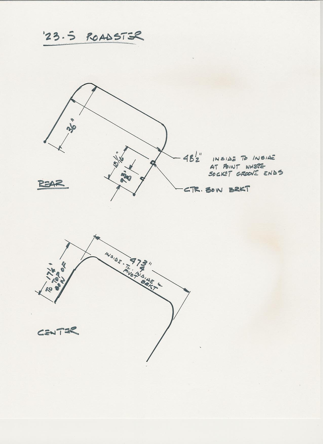

1926/27 rear bows have a slight curve at the bottom. If yours are straight, they may be 1923 - 25 bows. The clamps on the front bow point hollow side up. Here is a picture from the MTFCA forum showing the bow dimensions. The “stick” in the front bow has to space the clamps the correct distance apart to plug into the tops of the windshield posts, of course. Install the clamps onto the windshield posts first, then adjust the front bow dimensions accordingly.

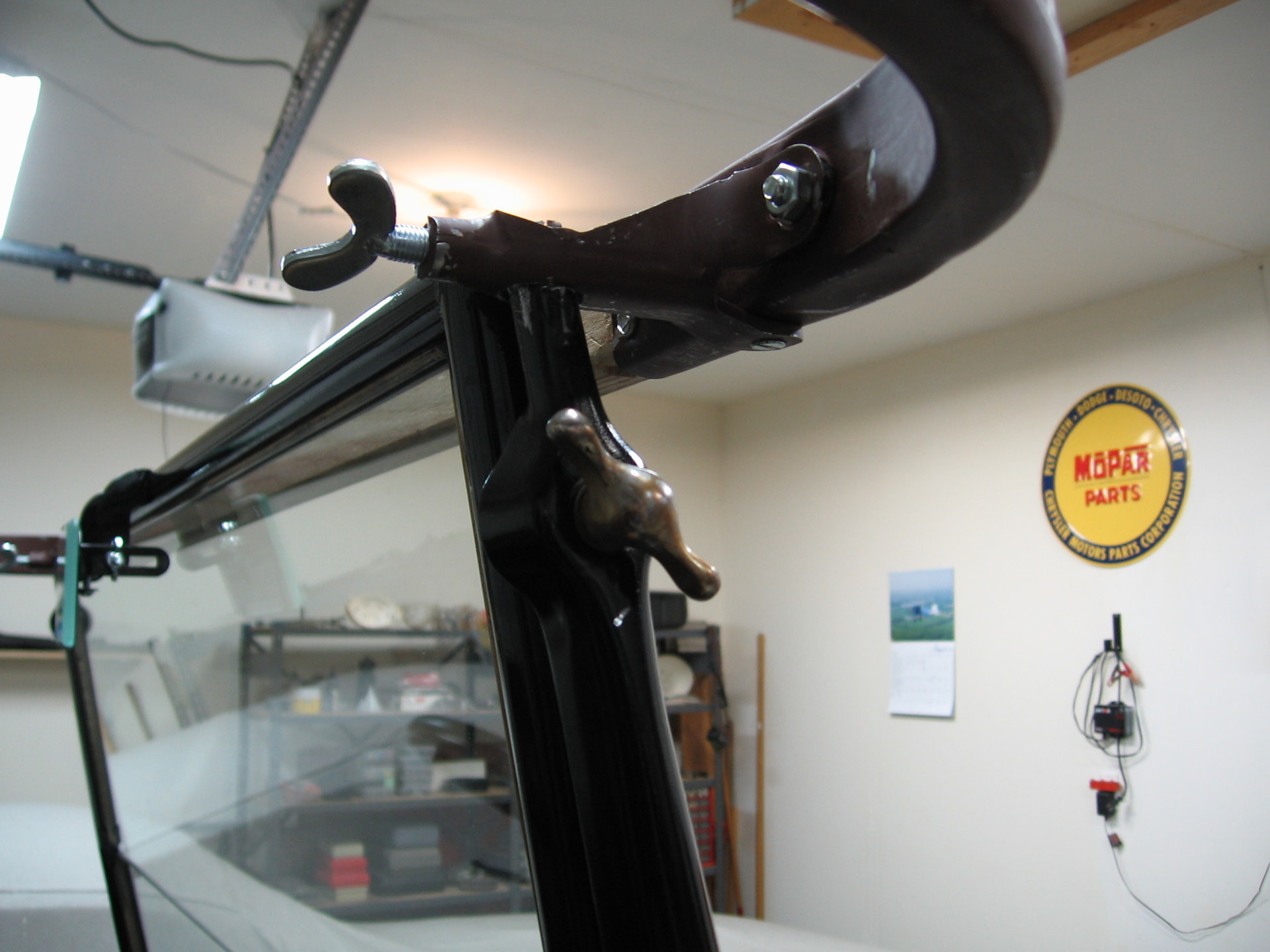

Here is a picture showing how the front bow clamps fit onto the windshield posts.
