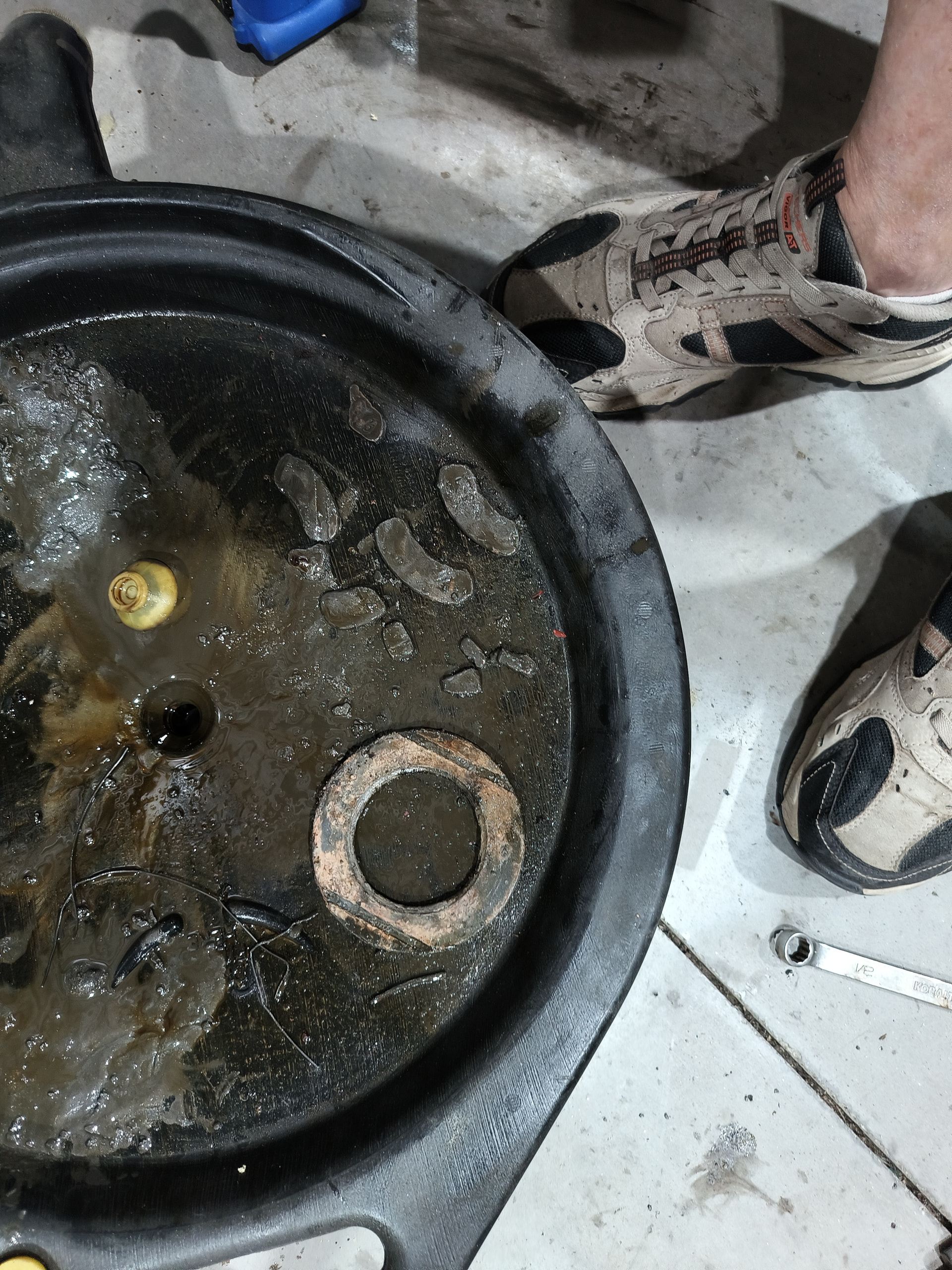

Help!!!last couple times I drove my T , I heard a clunking sound when stopping. Took it out today and the clunking sound was worse.a mile or two into the ride, it started clunking all the time with other horrible noises like gears grinding. Limped along for another mile or so and it stopped moving altogether. Had to tow it home and now, even in neutral, there’s a clunking sound when rolling. I fear the worst, any input or advice would be appreciated. Thanks
Sounds like a rear axle rebuild is in your future, see my reply to your earlier post.

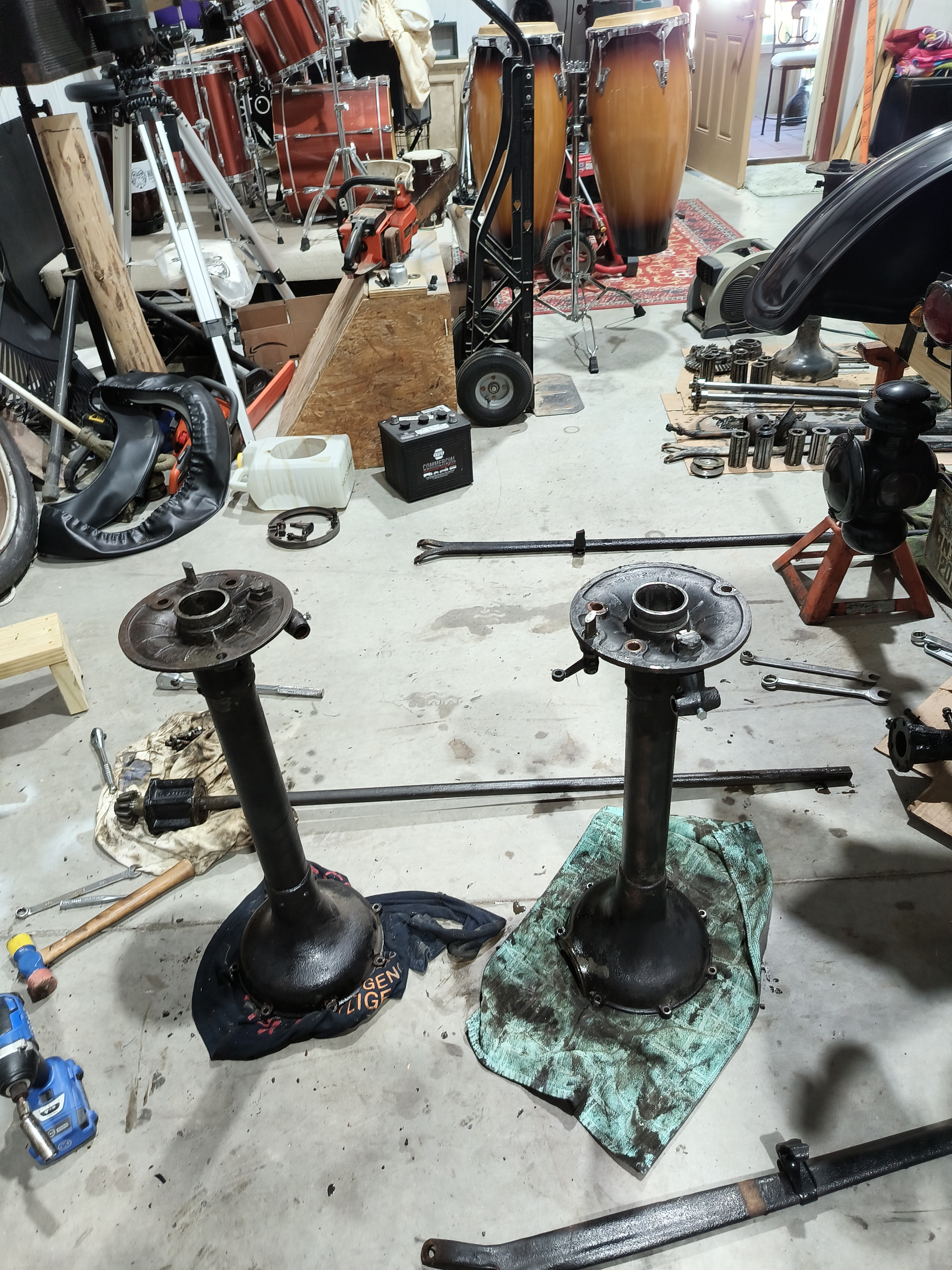

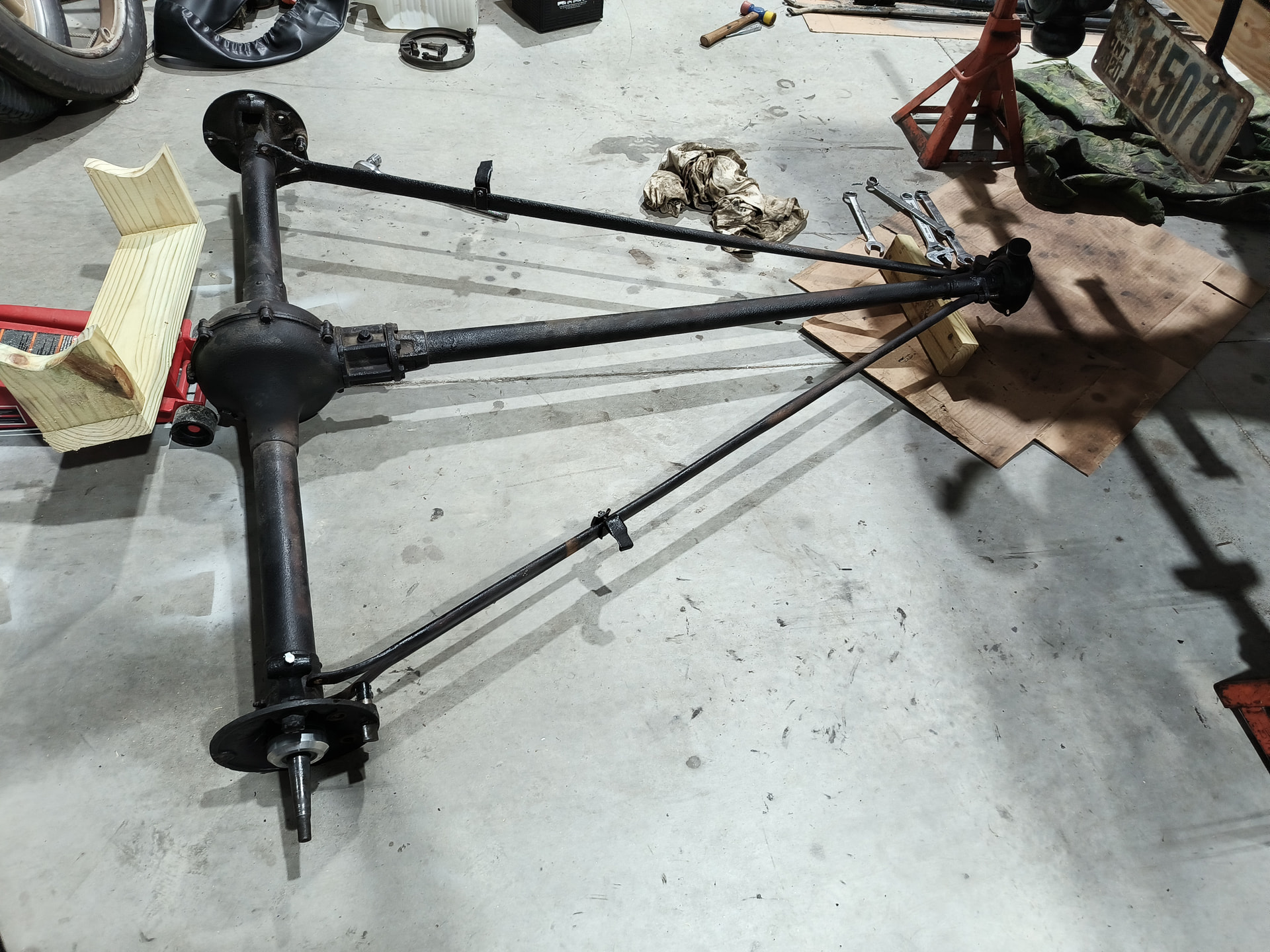

The kidney shaped pieces are what came out of the rear axle. The intact thrust washer is what it’s supposed to look like. That one is from another rear axle I used for some parts. All back together with all new parts. Test ride sounded good, felt good. No more bearing noise. I’m a happy camper. Now I’m having difficulty getting it registered. Apparently the guy I bought it from needs to give the DMV some more information. Keeping my fingers crossed.
