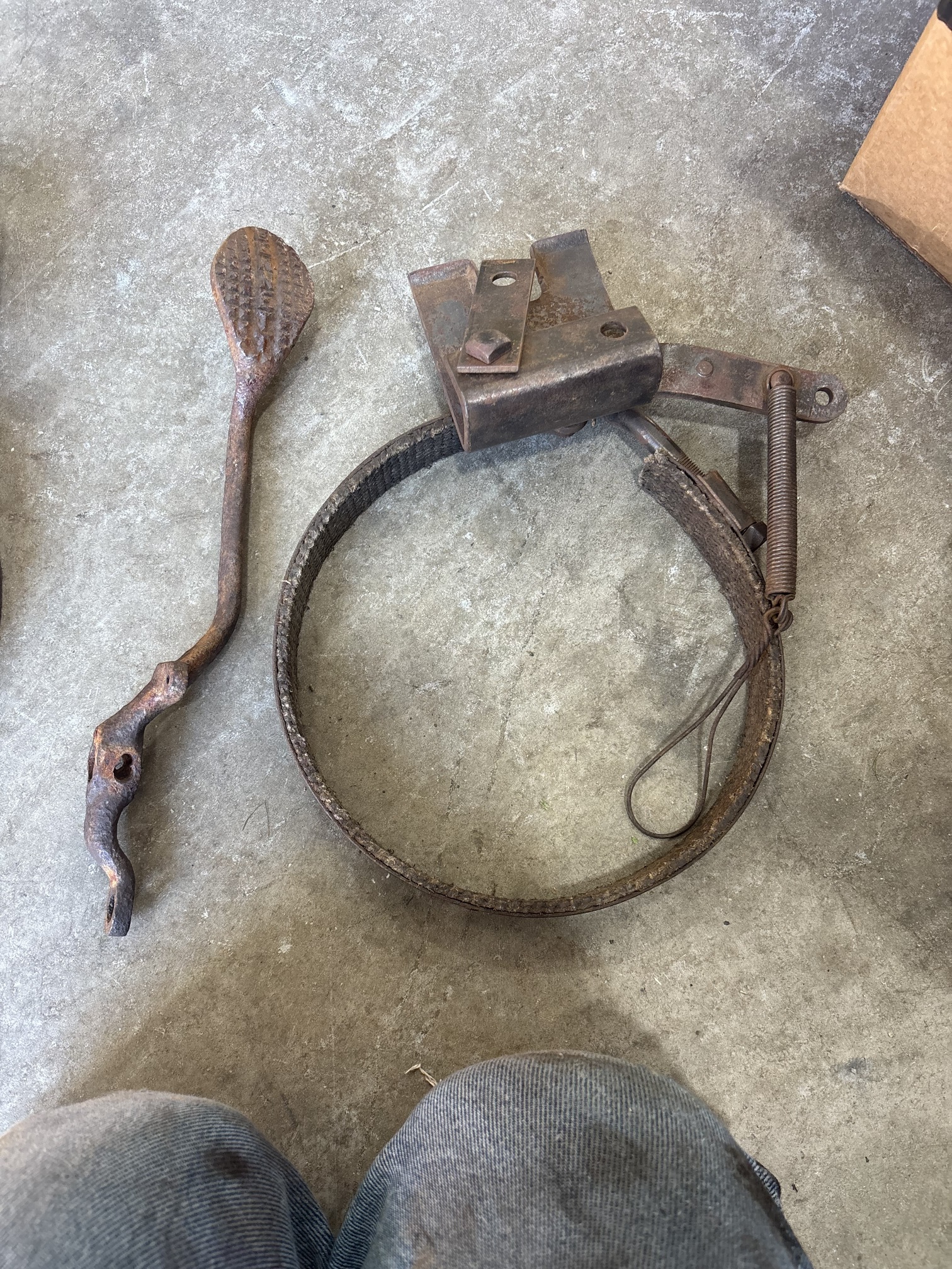

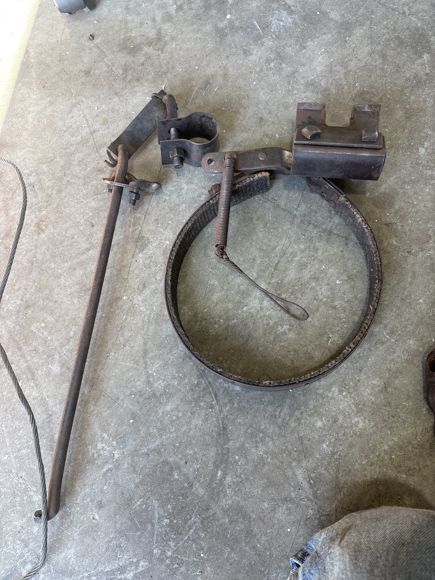

I found these brakes and was told they were ac brake but not sure how they attach to car. Does anyone know how? Thanks
Welcome to the forum! They look to me to be some other brand than AC, here are what my small drum AC brakes look like. You will likely have to move the mounting bracket around in the area of the brake drum and see where the holes in the brackets line up with some bolts that are already on the car.
Thank you. If not ac brakes do u have or know someone who does have a pair to sell?
Unfortunately, no. Keep an eye out on the MTFCA classifieds, perhaps someone there will eventually list a set for sale. The person who was reproducing them (Larry Sidmore) passed away a few years ago and nobody so far has picked up the business. Same for Richard Baughman, who made a nice linkage setup for them.
So after looking a little closer they appear to be Bennett brakes. If anyone has a picture of how they attach to the rear axle please let me know as I am not sure how they attach.
