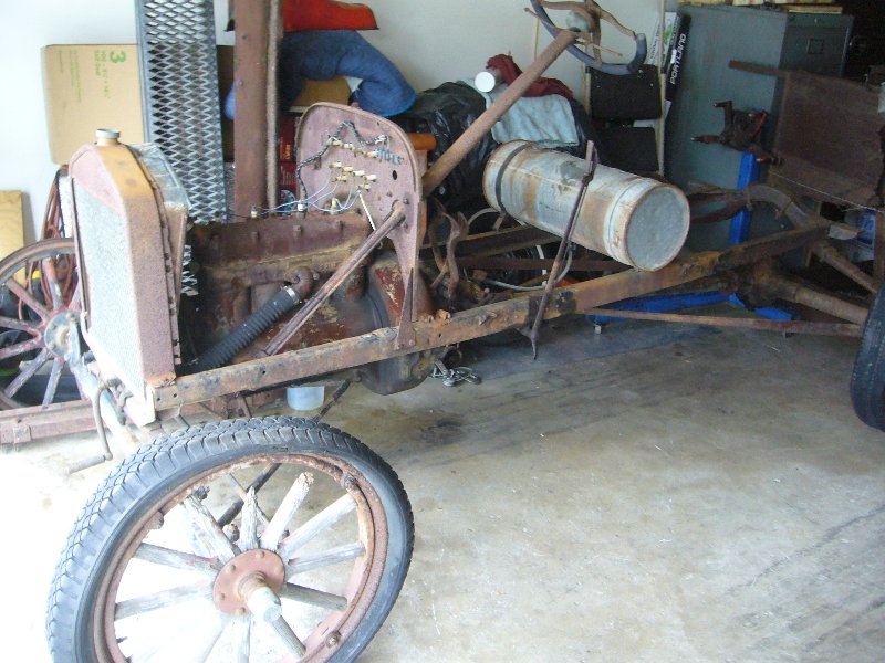

The first project was to discard the broken wooden-spoke wheels and replace with 19" Model A wire wheels with NOS tires. 5" X 5-1/2" adaptors from Ebay were mated to the wooden inner hubs by redrilling five holes. This arrangement only added 1/4" to the original Model T treadwidth.
The frame was roughly cleaned and painted with Rustoleum Satin Black. After replacing all three transmission bands, the car was somewhat driveable around the block, with the engine smoking badly and radiator leaking. A subframe of 1" box tubing was built, onto which a simple plywood pickup-style body and seat were attached, the engine body being bolted thru the original body attach angles. No welding or drilling was done on the original frame in case I ever find a good body. A '23 Cowl was narrowed 3" and fitted to the firewall with sheetmetal side pieces.
