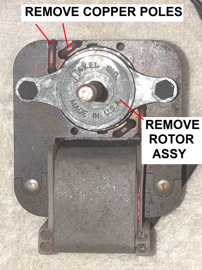

I used a motor from a fan.
The one I actually used is from an old microwave oven.
The one in the pictures is from an bathroom exhaust fan but is identical.
I simply removed the rotor assembly and the core copper (optional).
I hooked up a momentary pushbutton switch and a pilot light (optional) and a power cord.
I used a polarized cord and put the pushbutton switch in the hot side.
I mounted it into a plastic box and that was it.
