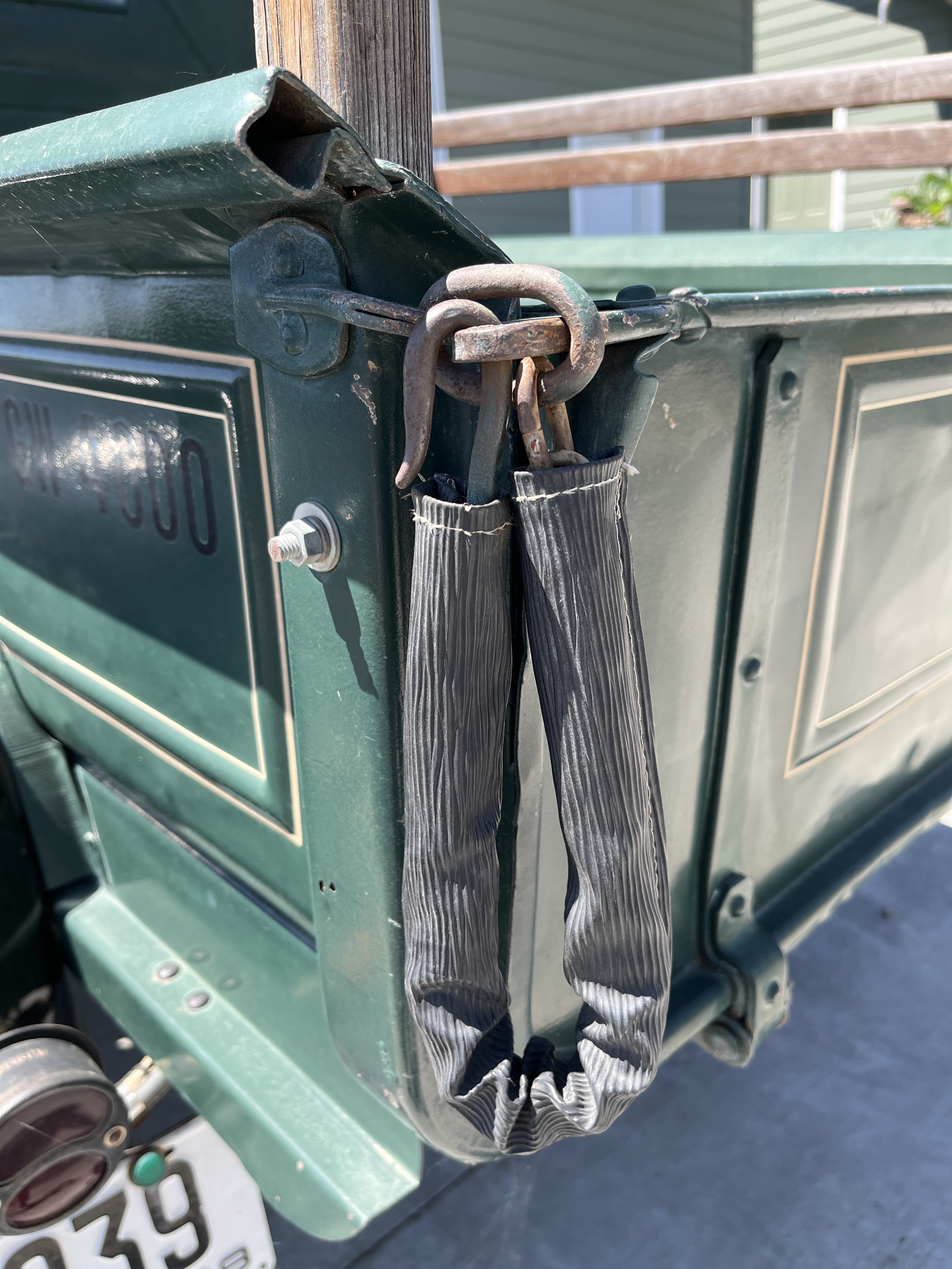

Here is a pic showing the tailgate latches on my 1924 cut-off touring with an aftermarket pickup box.

Looking at my photo gave me this idea! It will also keep the chain loops from banging in the body so much. We will see how it works out, but it shows lots of promise. Thank you so much!

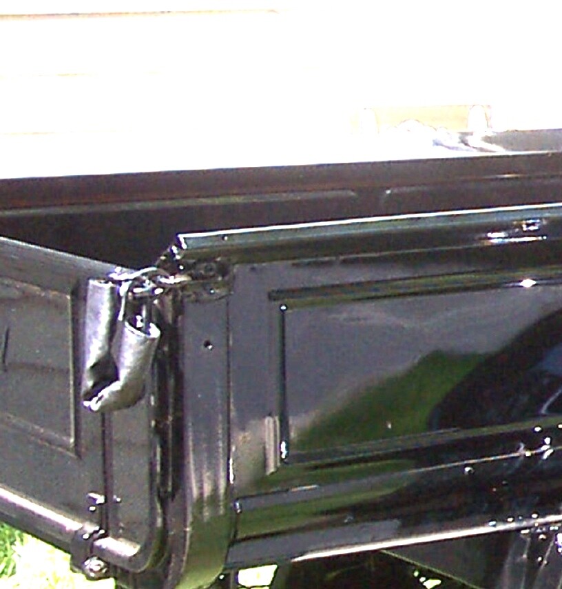

Use of the chain covers prevent rattles, and inverting the hook keeps it put too.
