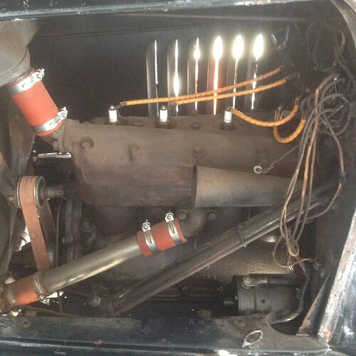

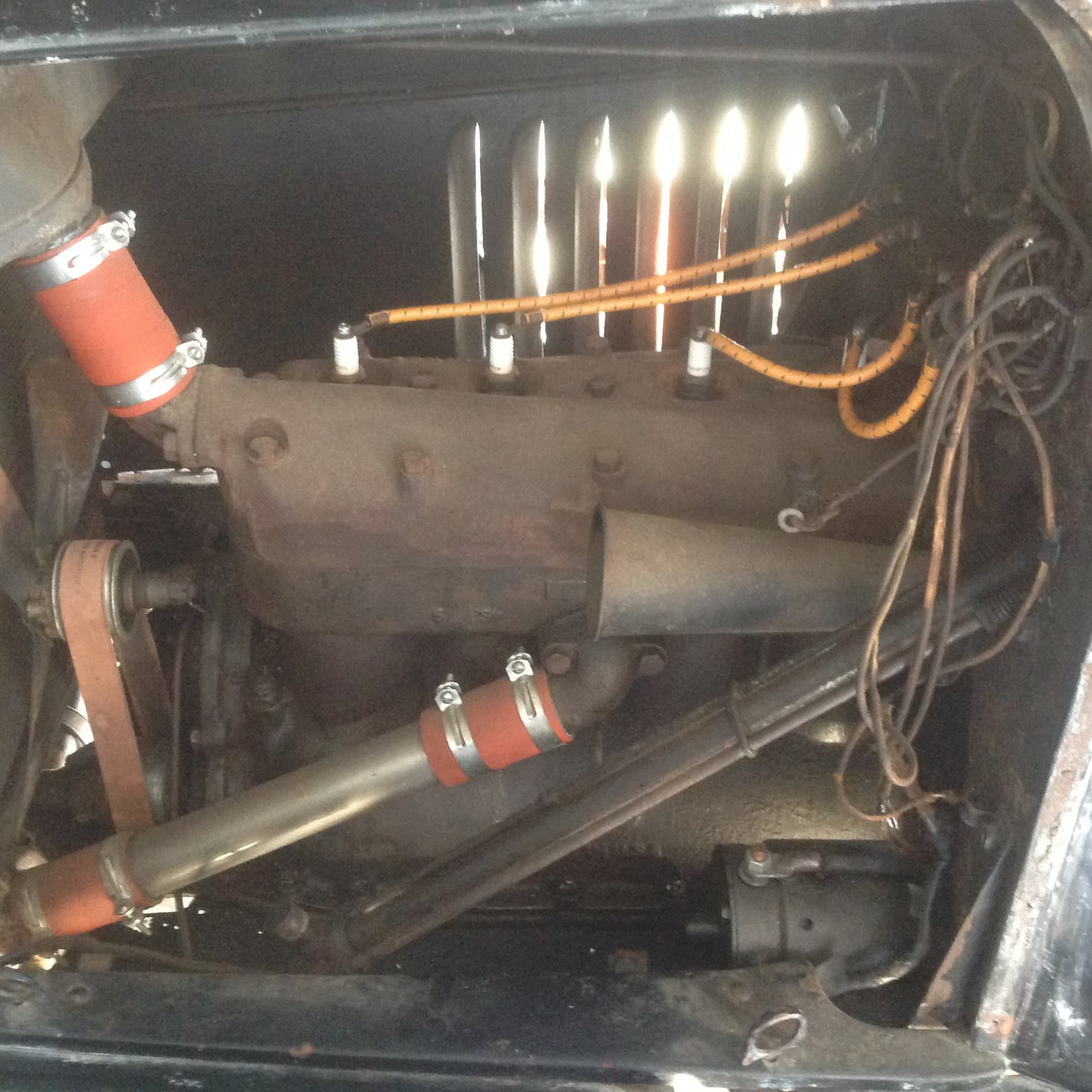

My ‘22 Centerdoor has a wooden dash and this is the best picture of the support bracket I have. I’d take pictures for you but I’m 1,000 miles away from the car now.
