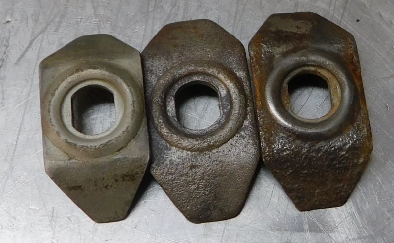

One thing you failed to do is to post photos of original bridge washers! There are four or five different styles used, made by Schrader, Dill and Bridgeport, and others, but they all do the same job. Do not use the current flat bridge washers which are not made correctly. In fact, don’t use any of the current valve stem hardware, as it is not the same as the original equipment.
If I had a lathe, I would make a set of dies to and use my press to put a circular dimple into the new flat bridge washers so that they would seal correctly.
The manufacturer already has to press the washers to put the “wings” at the correct angle, why they can’t press the dimple in the same operation is beyond me. ![]()
Your reply Mark is why I went into the reproduction business 20 years ago. I just turned over my half of the business today to my partner, and wish him well. The reason we started our business is because a big share of the companies making parts are cutting corners, and just plain not doing things right. I would welcome anyone into the hobby that is interested in doing reproductions correctly.
There is no reason for them to do that because the hole in the middle of the new bridge washers is the wrong size because the “modern” brass stem tubes have the wrong size stems for Model T. They don’t need that dimple anyways because they are vulcanizing the stem to the tube. They don’t want people re - using their valve stems. It would hurt their profits.

Here is a typical early bridge washer. Notice the sealing lip is a stamped brass piece that is crimped to the bridge washer.
By the late teens Ford was using these stamped bridge washers that had the sealing lip integral to the bridge washer.
There were all sorts of (aftermarket) fancier bridge washers of every size and description. Some were cast aluminum (left) others were stamped steel (right) or brass or even molded from hard rubber. Notice how the aluminum one on the left is cracked, this would cause a leak.
