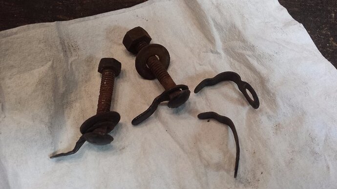

Looks like 7831/7832 side curtain hooks.
Yes they were on the windshield bolts so that’s what they are, thanks
The long one goes half way up the post. The short one goes below. Save those bolts too. They are special for the windshield posts, and should be raven finished. One of them appears to be bent.
